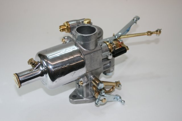

I am about to get the rover D3, restored by Burlen. Hope to share impressions.

Luli
Looking at your D3....I see it has the spring loaded jet assembly like my Wolseley carb. Do you have a piston damper on your piston?
Very helpful picture, it shows where levers & stuff should go!

Right now it is stuck at customs. As soon as I will get it I will be able to answer the questions.

by TonyG
David,
The big spring behind the jet adjustment nut is there to maintain pressure on the nut once the desired mixture has been determined. The black spring on the side of Luli’s carb is the choke return spring. The choke operating via the mixture knob on the dash and simply pulling the jet out a bit to enrich the mixture. In tandem with this is the throttle knob which increases engine revs by moving the brass lever that sits against the throttle stop, effectively opening the butterfly.
In case you were unaware, the SU carb is a clever device having a constantly variable Venturi (air way) and works by the accelerator opening the butterfly which, in turn, creates more vacuum thereby causing the piston to move. This opens the air way and moves the needle within the jet to allow in more fuel, making the engine rev more. As such, the shape of the needle has a critical effect on the progression of fuel delivery and explains why there are different numbered needles. Similarly, the tension of the piston spring determines the piston movement in relation to the vacuum that operates it. In reality it is a matter of trial and error to find the best combination of spring and needle. The jets are all the same size.
I doubt Luli’s D3 has an oil filled brass damper attached to the screw in end plate. Partly because Rover didn’t use them and because the orientation of the downdraft SU means that the oil wouldn’t remain in the damper. What puzzles me is that the Wolseley carb has one. I assume it is a D3 designed for downdraft operation? Very few cars used them this way around with side draft or angled being more common, as on an MG midget or Morris Minor. Both of these have oil dampers I believe. However, I did buy a pair of downdraft SUs at the NEC Classic Car Show a few years ago. No idea what car they originated from though and they had a different filter fixing arrangement like yours. Also they had a different number on the side cannot recall what it was. The Rover ones have something like 1492/2 on them. I bought them with a view to converting my 12 Saloon to twin carb operation but it runs so well that I have yet to do anything about it and I would need to fabricate inlet manifolds etc, which is more trouble than it’s worth really!
