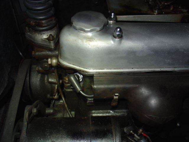

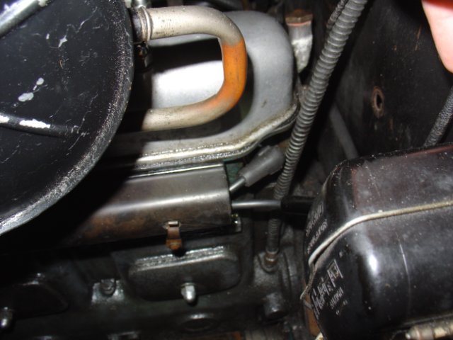

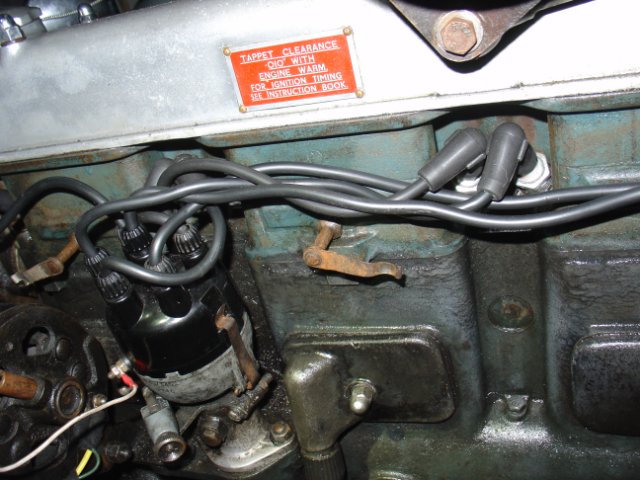

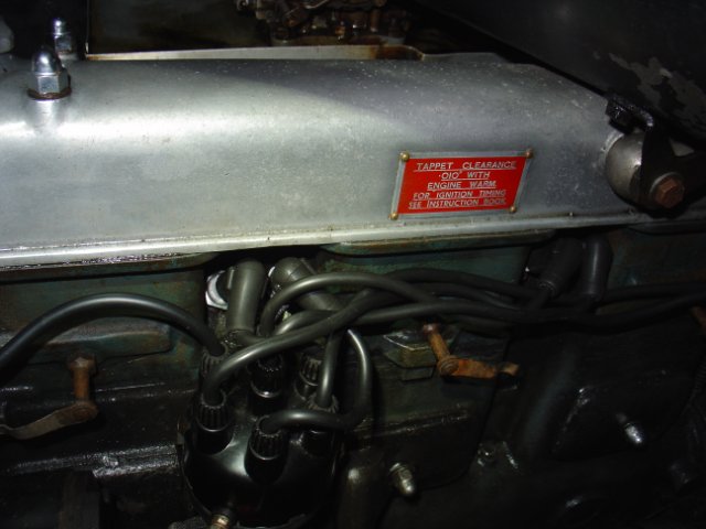

I'm adding some photos, please excuse the lack of tidiness but this particular car is a recent arrival and I'm working through what it needs. You'll hopefully see from the photos that the issues are both the length and width of the plug covers. Too long and your distributor /lead cover won't fit. Too wide and they won't have enough room for the centre cylinders. I remember years ago with a previous car having an intermittent lack of power and it was the brass screw on terminal on number 6 cylinder shorting out against the speedometer cable, preventable with some insulating tape once the culprit was identified.
