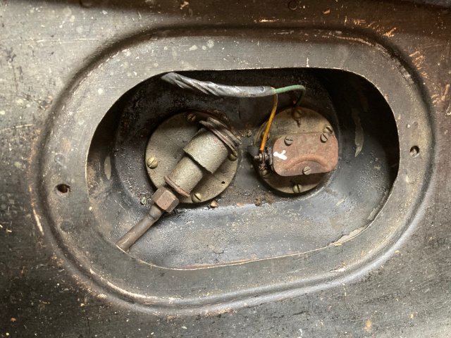

Post by David2021 » Thu Mar 10, 2022 11:12 am
Great pictures Luli, but mine doesn't look like that! The fuel pipe assembly has no wires to it! the only wires are to the sender! I have undone all the connections/bolts etc and will drop the tank at the weekend. I have some "slosh sealant" so will try that before looking at new tanks. I have had success with it before. The only downside is having to remove the sender (and the pick up pipe, but that will let me examine it!)

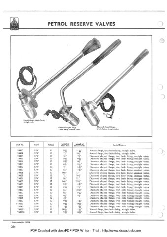

Reservevalve fromLucascatalogue400E.jpg (32.02 KiB) Viewed 12516 times
Just thought I would share this page with you. You will see there are only 4 options with the round fixing plate and it gives the lengths of the pipes for each. I will try to remember to measure mine tomorrow
It is from a 14 but it had had the same adaptation done to it presumably because the seal had failed.
Incidentally I found the replacement filter quite easy to make with copper mesh from the internet with a flat bottom wire sewed and soldered on with a flange. The top was a penny drilled twice to slide onto the pipes. Not pretty but functional and not seen!
Re: Petrol Tank 12hp tourer110
Post by RobHomewood » Thu Mar 17, 2022 11:48 pm
I measured the pipes on my unit today @ 9" and 7 3/16" approx but realise that the catalogue lengths include the threaded section too ie the overall length which I didnt get. I dont want to break the seals by detaching the pipes so sorry about that but looking at the difference in pipe lengths in each type would point towards type 78000 which is 1 1/2" diff, the closest to to my difference which is 1 13/16". You may want to check my maths!
