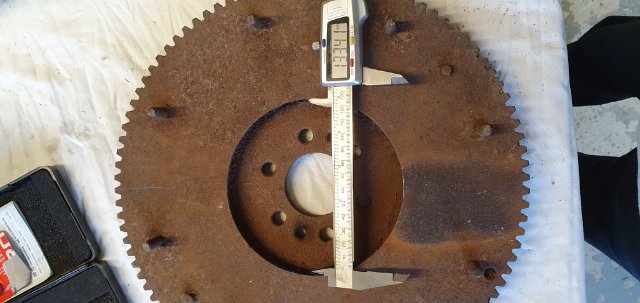

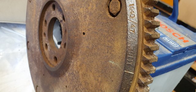

I have now had a chance to take some pictures. 4 cyl & 6 cyl flywheels are different. The recess in the middle to take the crankshaft is smaller for 6 cyl. I have shown as much information as I can below. Although it has some surface rust you can see the face is not scored and the teeth have no damage. It almost looks as though its never been fitted but I have no evidence to support that. I just wish it fitted my 12 hp. If its of interest send me a message and we can discuss a price.
