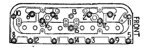

There are 5 studs: 2 long and3 short. there are 12 bolts. How many have you removed?

With regard to the diagram showing the bolt tightening sequence for the cylinder head, do you by any chance have a similar one for the 6 cylinder engine (which has 16 bolts rather than 12)? Or a link? Its not in the workshop manual nor in any of the service sheets that I have.
I would like to redraw the diagram in colour to make following the sequence easier in the workshop
Re: 1947 12hp
Posted: Sat Nov 27, 2021 7:15 pm
It is taken from an (excellent!) guide in "Motor trader". I don't have the 6 cylinder one. But look carefully and get the zig-zag idea.

Morning again Ive just been across to my friends to look at the head again All the head bolts/nuts are removed but there is not one in position 13,or a space for it They must vary according to year ,this is a 1947 12hp The head seems to be really stuck on ,Ive tried putting a bar under a lip on the head and easing it with a jack under the bar but nothing I have`t a copper hammer which it needs to tap round the head .,so that next time .Has anyone tried the 14mm threaded bar down the plug hole as a lever I said I wold give my friend a hand to remove the head but I am getting really involved

I thought I had posted a reply but unable to see it I went over to my friends and checked the head again this morning All the studs are out ,but there isnt one or a place for number 13 Someone who helps run a transport museum said when they have a stuck head,they have a long steel rod tapped to 14mm on the end ,which they screw into a plug hole to then try and encourage the head to move

I clearly see a short stud (#8) in place. Also 16 and 17. Remove all studs! long and short. then you can blow horizontally the head and it will come off. Use a block of wood as a buffer, or use a heavy plastic hammer.
