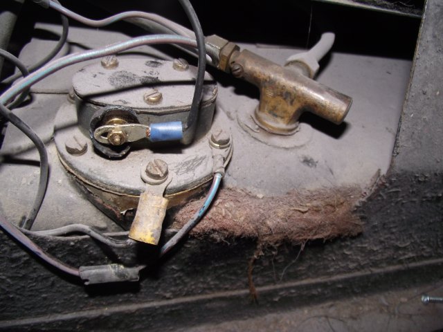

Morning I take it, that when the two pipes are disconnected from the tank,the outlet unscrews Len

Re: 1934 Rover 12 Petrol tank
Len,
Yes, the unit will unscrew from the tank. However, I think you will find that only one of them is a fuel pipe. The other is the mechanism for switching the reserve. I could be wrong as it's six years since I looked at mine! Have you traced the pipes to the engine bay? I'd be surprised if you have two arriving. All will become clear when you remove the unit.
If your fuel pump is drawing air it's possible that the change mechanism is leaking or that you are only getting fuel from the normal pick up and not the reserve. As such it would appear to be out of petrol when, in fact, you have some in there.
With the seals leaking and the change over mechanism very worn I modified mine so that only the reserve pick up worked, giving access to all fuel and removing the chance of leaks. However, you need to be confident there is no muck or debris in the bottom of the tank or you will be drawing that up.
Len,
Looking at the picture again, the LHS ‘pipe’ is actually the operating rod for the reserve. The RHS pipe goes to the engine bay.

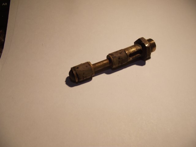

Found the problem,the slider in the reserve tap has seized ans was locked in the position ,not on reserve.So it was unable to draw petrol up the longer tube I`ll remove the pipe with the cork on it and replace the end,to seal the hole .No reserve tank,but I know where I am Len
Len,
It must be modified such that fuel can only glow up the longest pick up pipe. The short one must be sealed or you will be sucking air once you get to the reserve fuel.
