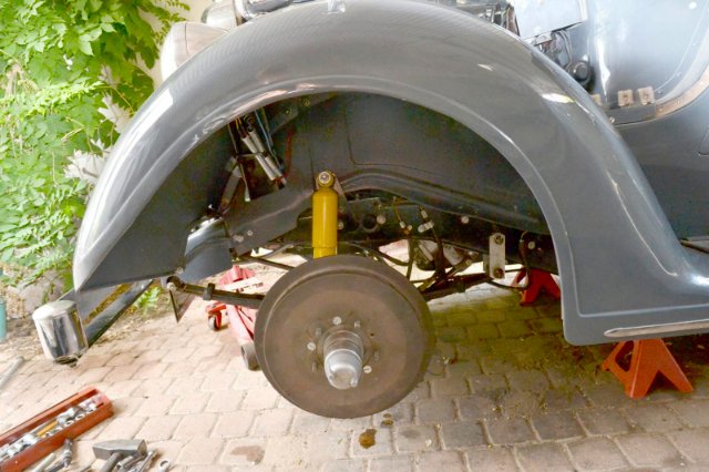

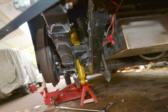

I decided to give modern telescopic shock absorbents a chance. It is not an irreversible move. See details here:
https://wp.me/pXLKy-3EU

Interesting Luli. Do you have any drawings for the dimensions of the brackets etc? No point in reinventing the wheel! I read many of your chapters yesterday via the Hebrew / English translation of course. I am intrigued that the "name" as translated for the Tourer comes through as "Terrorist"! I hope GCHQ is not tracking me! How do you get on with your Radial tyres? Do they stop the alarming "tramlining" when you find grooves or ridges (like white lines!)on the road surface?

Post by luli » Fri Jul 09, 2021 7:54 am
Sometimes the machine translation is really embarrassing like when it translates "pin" to "penis" or "type" to "sex" but the main idea is retained. The carefully built steering and the radial tiers combination is really great, and tarmlining is hardly felt.
