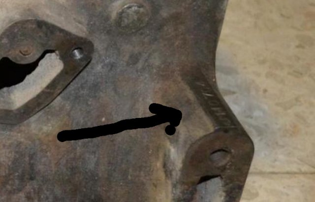

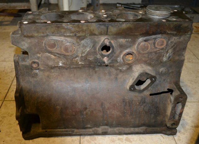

The engine number is on the driver side engine support "wing". See picture.
140 PSI is surprisingly high. Check valves.
