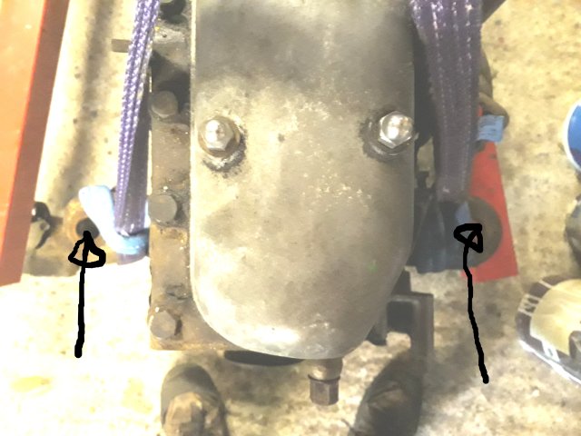

I am trying to draw up a footprint for the supports on a 39 Rover 14 engine (to have an engine test mount made) and having some difficulty in measuring the dimensions accurately. The engine I am measuring from is a spare one with another one in the car otherwise I would just measure the mounting points on the chassis. It looks from my first set of figures that the neaside engine mounting position is slightly further to the rear than the offside (16mm difference). Does anyone whether this can be correct? Any comments would be appreciated
Poor picture attached
Engine mounting points from above.jpg (61.97 KiB) Viewed 4521 times

Having taken a different base line to measure from and removing a pipe or two from in the way I am now pretty convinced that the mounting points are the same distance back from the front of the engine so I shall stick with that. Unless anyone knows better of course.............

My experience with 4 cylinders engines indicate that they are the same distance from the front, but not the same distance from the engine sides. This is because the engine block is not symmetrical to the crankshaft. There are also differences between LHD/RHD 10's mounts because of different chassis geometry.

Yes I had sussed out that the mounts are not the same distance from the engine block but are I believe symmetrical about the crankshaft (and the same height from datum).
