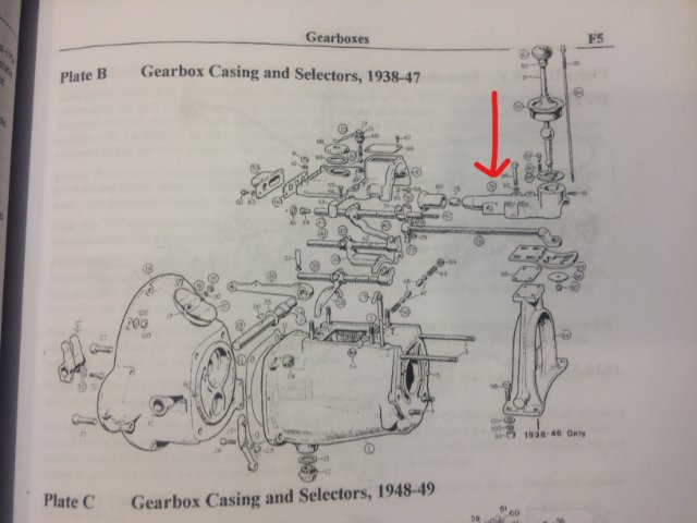

Also, the manual advises to remove the "four set-bolts securing the remote control housing to its support bracket, thus allowing the housing to float". I presume the remote control housing is the part marked by the red arrow in the attached diagram, but would just like to double-check. Thanks.

Yes. it is. The only tip that comes to my mind at the moment is be careful 0n the pulley. Pull the engine upward so that the front of it is higher (the engine is not leveled but inclines forward).
