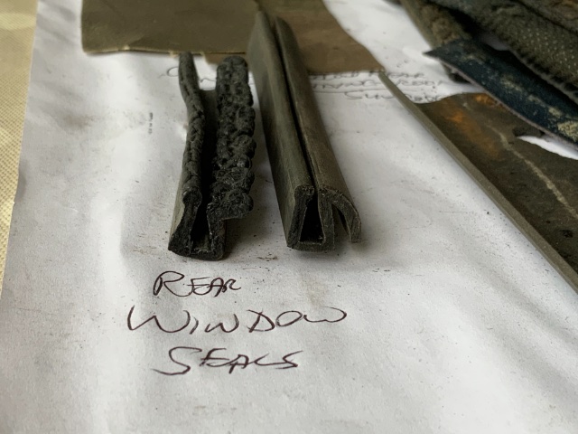

Time to put the glass back in, but just wanted to be sure that I have the correct profile for the rubber.
https://www.rover-forum.thersr.co.uk/do ... iew&id=200
The old seal has a round profile at the end of the inner upstand. Am assuming (from condition) that this is ‘original .. as it left the factory’ but over 84 years can’t take anything for granted.
Have sourced a very close match, but before I start can anyone confirm that the round profile at the end of the inner upstand is genuine 1936 Rover ?. ( pic shows original from car, and new that I have sourced).
Finally, does anyone have any good advice on fitting the windows ?. (Dry, wet, fairy liquid, oil, string to help pull the outer profile into place, cut to exact length or add a few mm to compress ?).

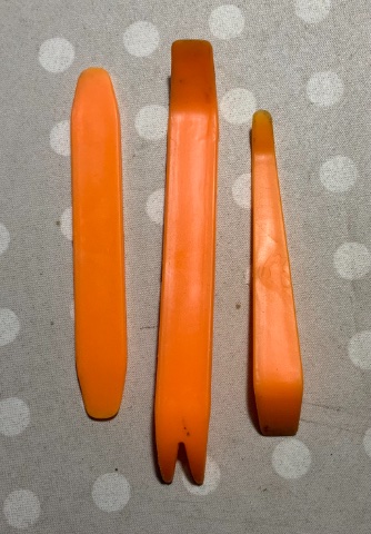

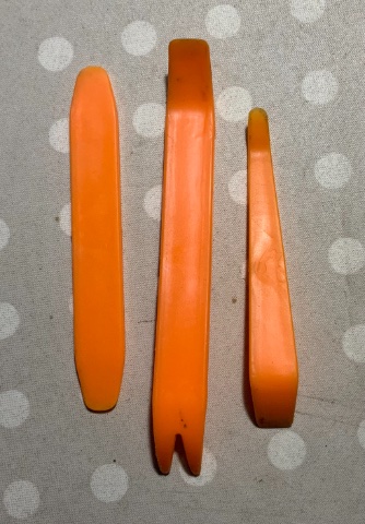

3. I used soft(ish) plastic trim removal tools to pull the external profile into place. No damage / scratching to the paint, and no damage to the rubber.
