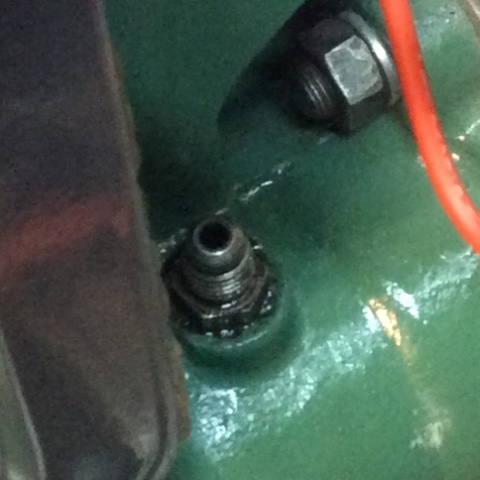

I have a 1940 Twelve and the oil pipe feed is 7/16 BSF block end and 1/4 BSP into the back of the gauage.
I can get a pipe made up by doing away with the adaptor (7/16 BSF to 1/4 BSP) that screws into the block but the parts book calls this adaptor a "Oil Feed & Rear Cam Bearing Locator". How critical is its length and diameter to this locator function?
The reason I'm asking is I screw into the block a 1/4 BSP (male) to 1/4 BSP (male) fitting I could use the nylon pipe available from Speedograph.
Why would Rover go from 1/4 BSP to 7/16 BSF and back to 1/4 BSP ................ or has someone cobbled this together to get them out of trouble?

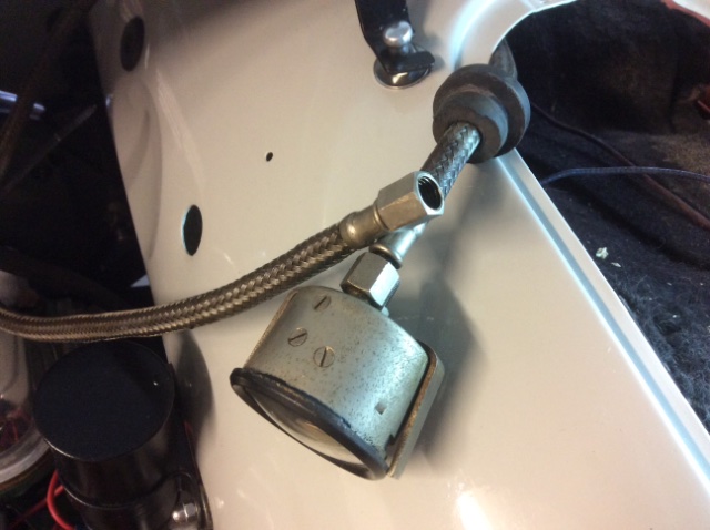

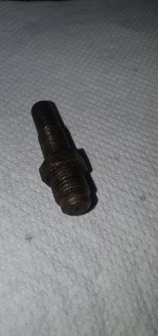

Taken a couple of pictures. As I thought both ends of the pipe are the same thread size but the adapter end is longer. The nut size is 1/4W.
Hope this helps a bit. If nothing else, you can compare with yours to see which bits look the same.

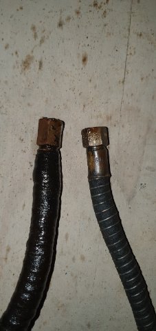

Yours looks identical to mine so I think I'll go down the replacement hose keep the fittings route.

The fitting is longer where it screws into the block as it extends down and locates the cam bearing.

...............so clearly a fitting the supplies the oil pressure to the hose but doesn't extend down to locate the bearing will lead to problems with the bearing at some point?Rubythursday wrote: ↑Wed Sep 16, 2020 9:45 pmThe fitting is longer where it screws into the block as it extends down and locates the cam bearing.

yes as the cam bearing could turn.
