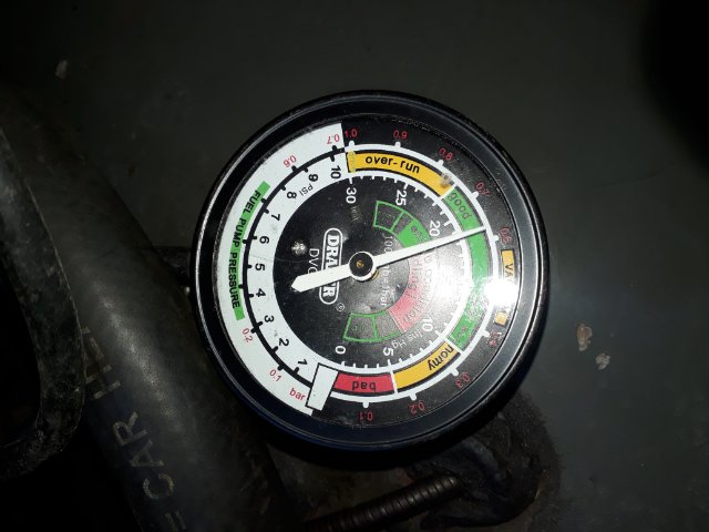

Give it a try, Tony! it is such a nice feature, almost unique to Rover. And Rob, use a vacuum gauge to monitor the tick over inlet manifold vacuum. Sometimes a leak somewhere can be the source of the problem.

Just a bit of feedback - I dont want to hog the Message board but I did test the manifold vacuum as you sugegsted and once the engine had warmed up to about 75 degrees the gauge gave between 18 and 19 ins Hg (about 0,625 bar). This shows the engine economy as towards the good end of the scale but the reading was still bordeline between good and bad engine condition, whatever that means. I have tinkered with the tickover speed and the idling screws and will try it out shortly

The idle vacuum also depends on the ignition timing (distributor micrometer). Have you tried to optimize it?
