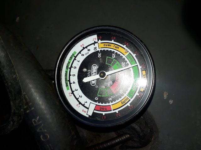

Post by RobHomewood » Thu Jul 23, 2020 7:00 pm
Hi Luli
Just a bit of feedback - I dont want to hog the Message board but I did test the manifold vacuum as you sugegsted and once the engine had warmed up to about 75 degrees the gauge gave between 18 and 19 ins Hg (about 0,625 bar). This shows the engine economy as towards the good end of the scale but the reading was still bordeline between good and bad engine condition, whatever that means. I have tinkered with the tickover speed and the idling screws and will try it out shortly

Post by luli » Fri Jul 24, 2020 7:58 am
The idle vacuum also depends on the ignition timing (distributor micrometer). Have you tried to optimize it?
