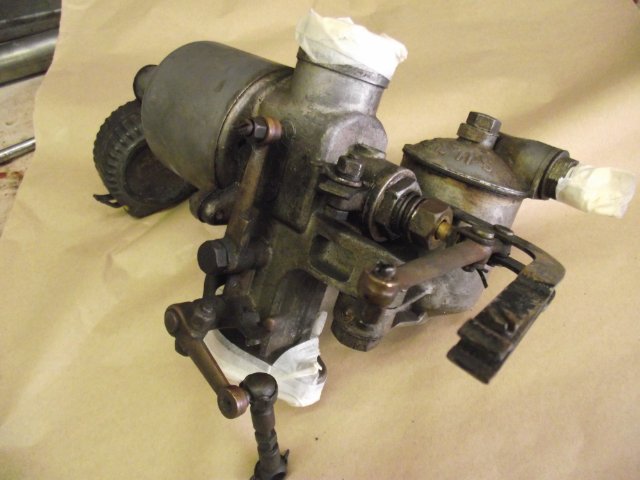

Afternoon I`ve taken my steering box into ICS so now have to wait for it to be rebuilt.On my 1934 Rover 12,the SU carb hasn`t a plunger connected to the top plastic cap as usual SUs carbs have and looking at a drawing of the carb .in the workshop manual it doesn`t show a plunger is this normal .Also there is a knob on the dash which operates the long brass lever on the carb whats that for .There is also a choke knob on the dash which is normal I have never met the control for this brass lever ,its the vertical one at the front of the carb Len

Re: 1935 Rover 12
Len,
I replied to this query on the other thread on Saturday. Suggest you stick to a single thread to avoid confusion when asking about the same subject.
