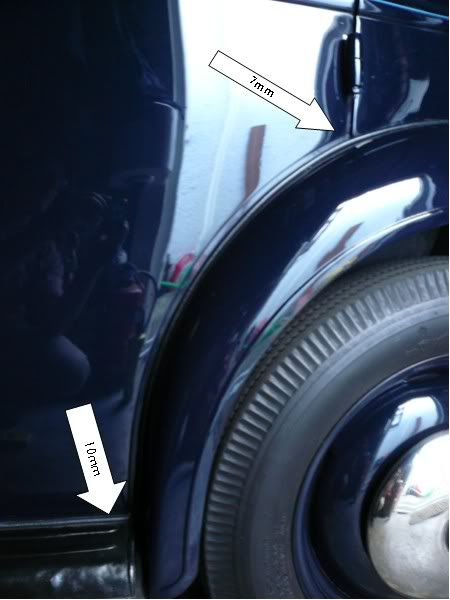

I've just checked mine and at the top of the arched section I have 7mm from the outside door skin to the D post and at the bottom of the arch I have 10mm. The gap gets tighter towards the front of the door
