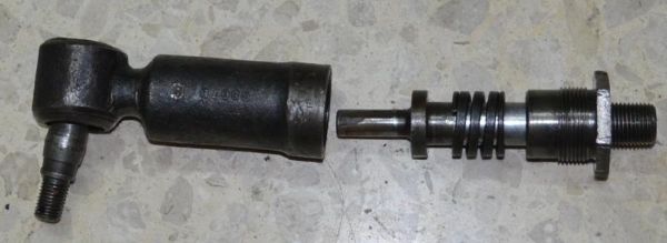

If I were you I would start by checking shock absorbers are working properly and filled with the correct oil, next that the king pins & bushes have no play, then check the steering balljoint that fits onto the steering idler arm, they are a known source for causing problems and I'm unsure if it's mentioned elsewhere on the forum, next check track rod ends. There is a mention on the forum of the wedges fitted to the front axle, do a search and read about them and the correct fitment

All ball joints are good, However I did not recognise the ball joint nearest the steering drop arm as the one shown in the picture posted by Luli it seems to be a regular joint without any adjustment , next I went through the dampers , both were full of oil and seemed to be working well although the rubber bushings on the arms will need replacing, I disconnected the ball joint at the steering drop arm to see if there was any play in the steering box , this also proved to be very good if I am checking it correctly by turning the drop arm to check fro play, whilst this was going on I had taken all the wheels to Quickfit to have them balanced, this proved to be worth while as the fitter said he had a hard time balancing them due to how bad they were, the worst had to have 15 weights attached and the best 2 weights attached, I was hoping that this would be the problem so I fitted the tyres with the least amount of weights attached to them to the front axle.

I suspect that not having the correct ball-joint assembly (Rover part number 42843) is the main responsible for the shimmy. This assembly, if sound and when adjusted correctly, prevents the shimmy. Try Mike Couldry or Mike Evans or Freddy Boulton - they might have it.
