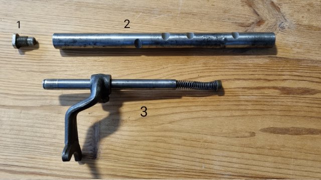

These are the components which are responsible for revers engaging:
1 is the ferrule 2 is the revers shaft 3 is the free wheel shaft .

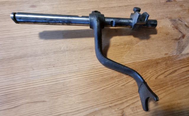

This is the revers shaft assembled:

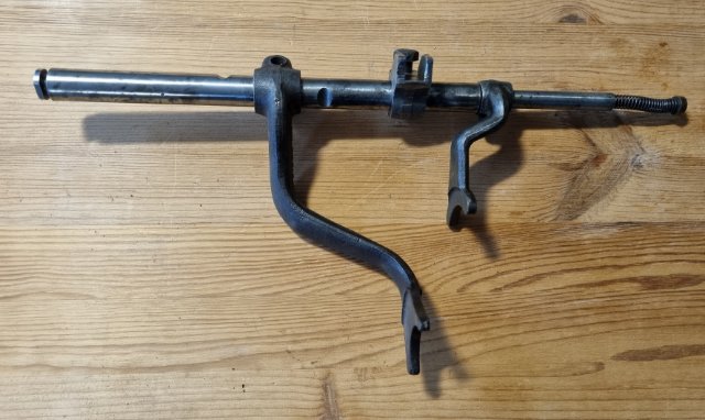

In the next picture you can see the gear moving fork and the gate. This shaft has two positions 1-neutral 2 - engaged. In the neutral position they are separated, not touching.
Engaging is done by the gate pushes the shaft backwards. Now both shafts are united. It simultaneously engages the revers gear and moves the locking gear into the freewheel.
The spring is active when driving forward in the 'fixed' position, but is not relevant in reversing.

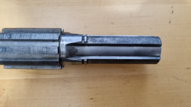

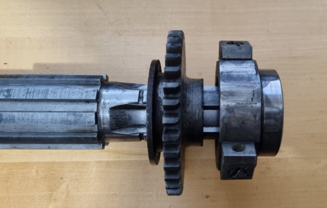

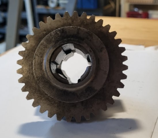

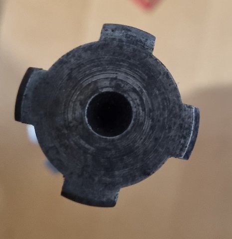

The back side of the main shaft. The freewheel ex-center and free/fix gear are mounted on it.
This is its profile

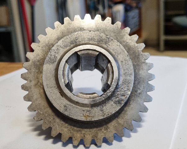

here are both parts mounted on the shaft
for that they must be aligned.
not Aligned.
To align rotate the freewheel shaft until they are aligned. Than it will slide in nicely .

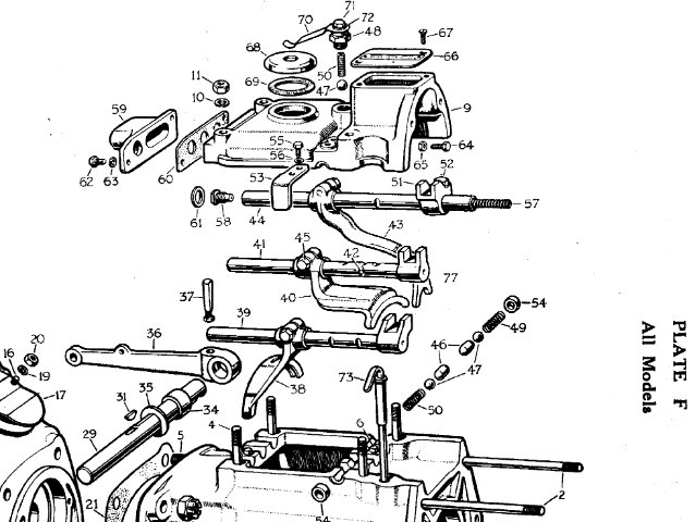

I suspect that the issue is in springs 50, 49 or the corresponding balls (47, 46)
