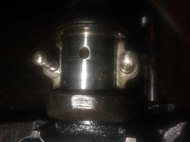

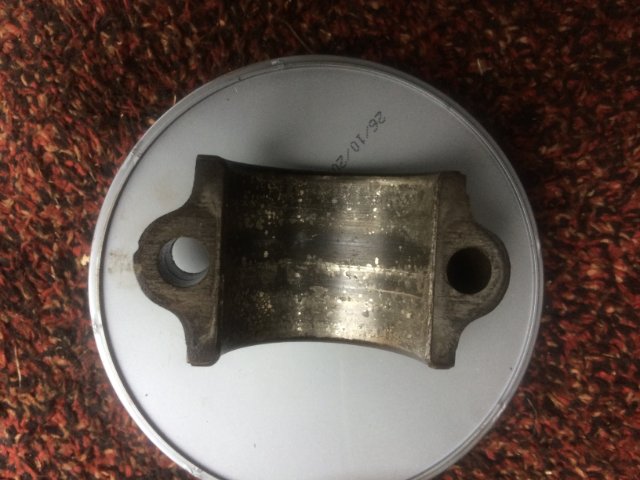

Work is proceeding a bit slowly because of limited time and the fact that every nut etc. seems to put up quite a fight before allowing itself to be removed. I have removed number 2 piston con-rod cap and the crankshaft journal looks a fair bit smoother than number one, though not entirely unblemished. I'd welcome a second opinion about state of number 2 con-rod cap bearing — as far as I can tell the metalling remains intact but it looks a bit patchy, and lacking experience in these matters, I'm not sure if it's still ok. Thanks.

The dots you see in the white metal are particles which were sink inside it - indicating bad filters, poor oil pump or dirty oil jackets. And there is no alternative to measurements when it comes to bearing-journal state. Plastigauge is a good candidate. There is an old saying about the road to Jerusalem: The first which looks short but it is long. The second is that looks long but which is short: Remove the engine from the car, take it apart, clean and check everything and correct as necessary. Not only the work will be much easier comfortable and accurate but little chances that you will have to start it over very soon.
