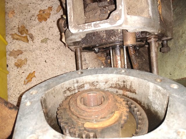

Hello Rob, in for lunch, so far so good. Rear cover plate fixed, old thermostat cover removed and no studs broken so far. Back to yours, the freewheel comes off as a separate unit, nothing will fall out except maybe oil ! There are bolts at the bottom but at the top the unit is held on the gearbox by two long studs, 4 3/4" long, so you'll need to clear them to remove the freewheel from the gearbox. However, there is good news. I have managed to remove and insert the long spring with the freewheel still on the two studs, pulled back just over three inches. Hopefully a picture will be worth a thousand words :
I've bent the spring down so you can see it is sufficiently flexible to come out of its housing and be removed from underneath, or maybe from the top.
Hoping this is of use and thanks very much for offering assistance: mutual aid will either be the success or failure of older vehicle ownership.

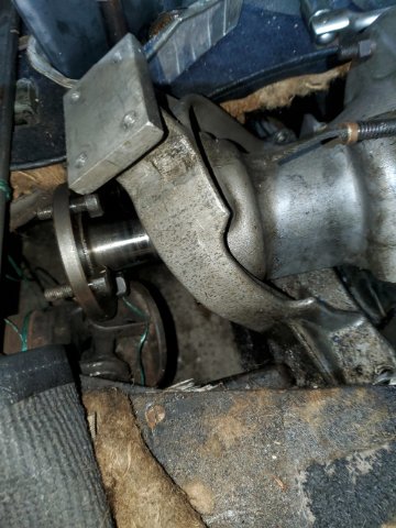

A frustrating day. Having successfully separated the freewheel housing on the spare gearbox without issue I started on the box in the car. But it turned into one of those jobs that at each stage another factor has to be dealt with. I removed the gearstick remote unit and the restraint strap for the box mounting. i managed to separate the prop shaft from the end of the box - with a lot of rubber mallet work and lever effort - so it dropped down below the shaft OK. I then undid the bolts under the chassis holding the hoop mounting which supports the remote shift unit but it wouldnt come out altogether as the bottom flange is too big to pass the chassis elements and it wont slide off over the freewheel housing. The photo shows the support hoop at an angle, jammed on the freewheel housing which is as far as it will go
Nevertheless I went on to undo the fixings under the car again for the gearbox mounting lower half cradle. However because the other hoop support could not be removed this part was unable to be removed either. I needed it to go so that I could get to the lower bolts holding the freewheel on. I tried jacking the gearbox higher but it wouldnt move far enough. I am also concerned about being able to replace these bolts afterwards. Currently I am stuck and run out of ideas..

Just looking at your last picture; are the floor panels removable? It looks as though there is a fixing screw on the corner, suggesting this may be the case and possibly allowing you the room to get the gearbox bracket out the way.
I know it seems as though the whole car is in bits but this is what I had to do back in 70s to get the box out of my Tourer. My car has wooden floors of course and, while it is useful to remove the gearbox from within the car rather than lifting the engine and box together, it still involves taking a lot of it apart!

Anyway you are right the floor panels do come out although the chassis framing remains. But it could help to get better access. I have also decided overnight that I will remove the tail shaft assembly and then the oil seal retainer to see if that allows the support hoop to get past. It may still not be entirely removable but if laid horizontal it could give more room to move the mounting cradle away from the bolts in question.

But I went back to the car and continued with Plan A. After withdrawing the stub shaft from the rear of the freewheel housing and a couple of bolts from the end cover I could see that the support hoop was not going to pass over the casing for removal because of 2 bulges in the housing which were wider than the aperture.

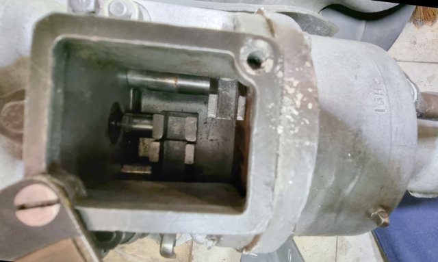

I have just made a little experiment on one of my spare gearboxes. I Removed the long spring and engaged the reverse. It works, and reverse is active. I am busy now so I will elaborate later, but read my comment above. I am afraid that you are on the wrong track, nothing to do with the long spring, most probable - some dirt or similar.
This is how the gate should look like when reverse is engaged.
