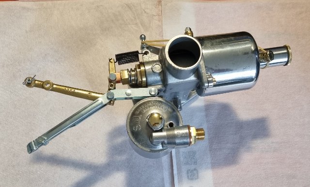

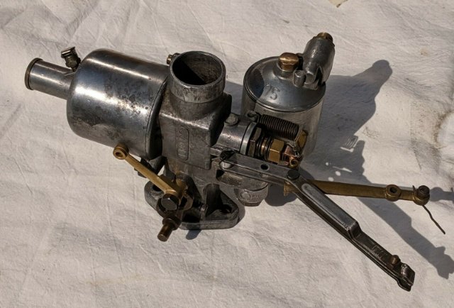

The restored carburetor has arrived yesterday, see before and after pictures.
There is no damper.
I opened a discussion on Facebook and Goeff Meller argues there the following: "The SU with horizontal slide chamber does have an inherent tendency to bind, and to wear oval, obviously due to the weight of the slide lying on its side. Worse still if attention is not paid to the supply of clean air!".
I am going to test the carburetor on my test engine and compare it to a self restored Solex.
After:
before:
Posts: 322
Re: SU Downdraft carburettor in place of Solex
Post by TonyG » Wed Apr 06, 2022 8:10 am
Hi Luli,
Looks very nice and it will be interesting to hear how it compares.
A small point; I notice that, during the rebuild, the mixture control lever has been mounted onto the opposite side of the carb. An easy mistake during reassembly, but it means your mixture cable will arrive onto the wrong side and also there is nowhere to mount the throttle lever cable as the only place now has the mixture return spring in it. A simple matter to swap around but I thought I’d mention it to save you puzzling over what is wrong!

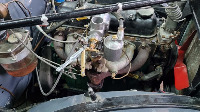

The S.U. had been installed in the tourer. First impressions: Better idle, not noticeable difference in performance. But these are only first impressions.
More details here:
https://lulis.org/2022/04/13/%d7%a2%d7% ... 9f-%d7%91/
