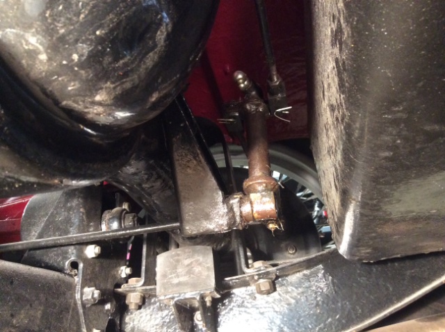

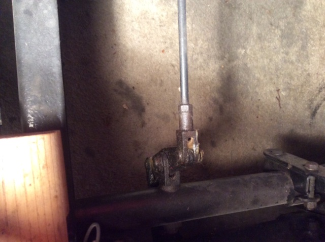

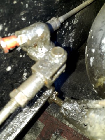

Here are some more picture of the balance and the way it is assembled. I added two washers to explain were to have them if necessary. Remember that brakes are basic safety device and must be properly set. I suggest you find a co-operative garage and work with them according to the workshop manual. They have the required ramp or pit.

Look again at the following picture: It shows clearly that the part that connects to the main rod is turned backward. Always remember that the wheel rods are pulling the pistons of the expanders . When that lever is pointing backwards the moment increases as the rod is pulled, which is exactly what is required.

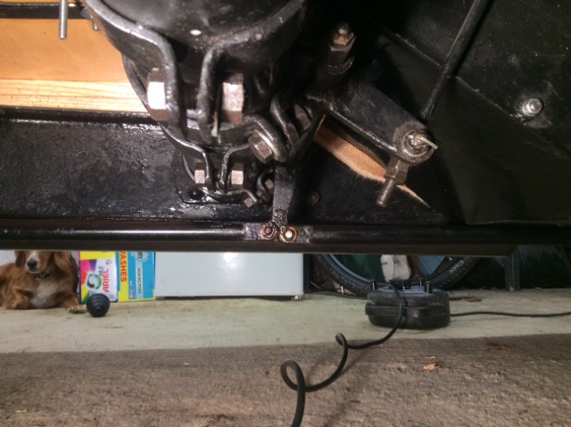

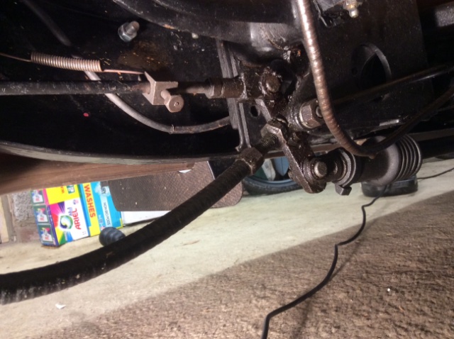

Rob, some pictures of my 36 Tourer. Should be similar to your car. These were all taken with hand brake off to show key points in system. I wouldn’t normally upload so many pictures but I think it might help you to see another one.

I'm having an 'off' day today but looking at the manual again I've found the part where it says the end of the bottom lever to the rear compensator should be 3/4" back from parallel to the axle and 1/2" clear of the fuel tank. This is as Luli said perviously.
Now, mine is roughly parallel to the axle so I would need to lengthen the long rod to meet those criteria not shorten it. This may put the other settings out forward of the rear axle so I want to consider this some more. Again I may need a garage to help with this as Luli suggests. My knowledge is growing but is found wanting every time a new subject comes up and finding a mechanic/garage locally with suitable in depth experience isn't easy. I know an engineer who would probably be able to rebush the brake rod ends (as Mike suggests) but he hasn't got garage facilities to help with the setting up.
(You can just make out the long lever below the offside balance rod in the slightly poor picture which was taken through the wheel arch looking slightly down and back to the compensator. You can hopefully also see the somewhat gungy piston partly out of the bore near the centre of the pic )
