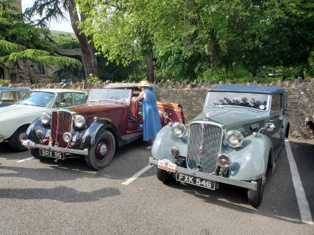

Hi Luli
Yes it would ahve been good to be able to see you at the event- I talked to a couple of other people who said the same. Maybe one year?
My reg is FXK 546. She may not show in official pictures on the field becasue we were late back from the hill climb and missed the judging but here she is next to Godfrey Owens 16 DHC in the hotel car park

Post by luli » Fri Jun 16, 2023 8:19 am
Thanks! My wife agrees.
