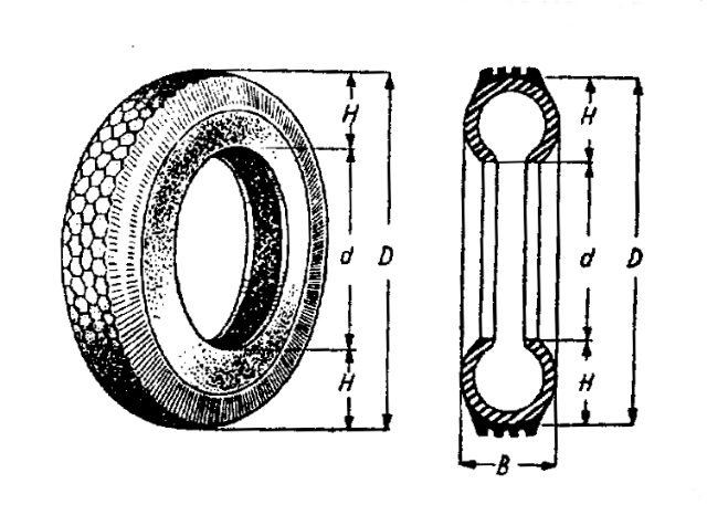

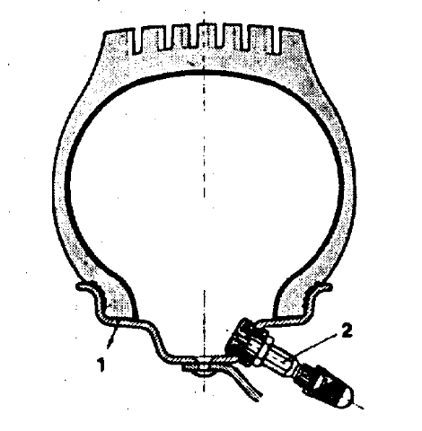

Some more information on cross-ply tires. There is a difference between the rim width the the tire diameter. The same rim can support many tire diameters. What is special about the "R" tires is that they retain the same cross section as the "X". See attached pictures.
3- cut.png (40.42 KiB) Viewed 22177 times
4 -midot.png (161.05 KiB) Viewed 22177 times

The rim width at the well is 3½" on our 1939 16 17" wires
Posts: 671
Re: Cross Ply tyres Vs Radial Ply tyres
Post by luli » Sun Oct 31, 2021 4:14 pm
It will except both 17X550 and 17R550. BTW, my easy clean 1947 wheels have the same width.
