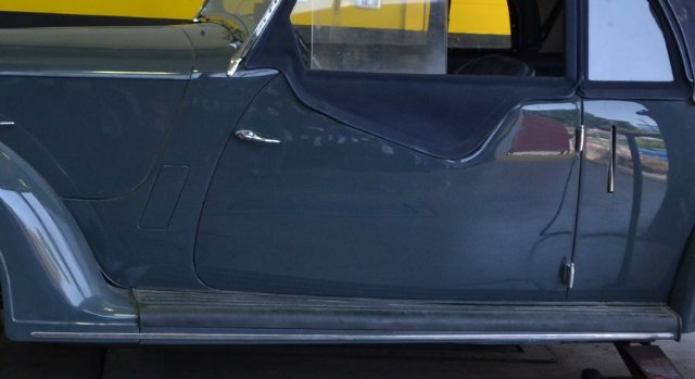

Post by David2021 » Tue Oct 12, 2021 3:22 pm
My 1947 tourer has no plated trim strip along the vertical face of the bottom of the front wings & the "step board valence" Looking at the parts list there is nothing shown as "replacing" or "additional" so it looks as if the strip is the same as the 12 saloon(held on by two 2BA screws and 10spring clips)
The photos in Howard Jones' excellent book show some with & some without! Most look about 1/2" or 3/4" deep, but there are some with full depth strips or even one strip for the wing & one for the step board!
Any advice ? ideas?

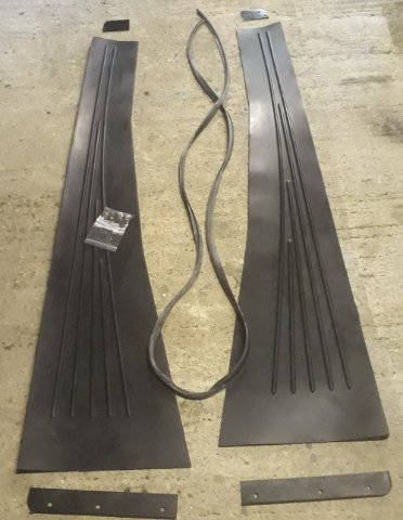

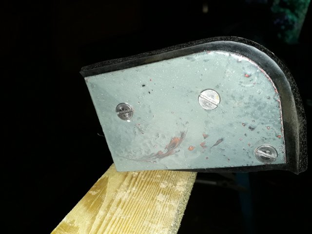

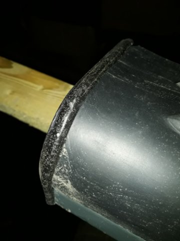

There should I think be an almost flat rubber gasket between the front wing and the stepboard which slight rounded overlap profile to the top the outer corner of which is curved to the same profile as the stepboard. See pic below showing all rubber compenents with the front gasket at the bottom. It is held in place by the fixing bolts between wing and stepboard. There is a similar gasket at the rear end of the stepboard but this is fixed to a small meatal plate and doesnt tough the rear wing which is pretty small in this location. 2 views below showing small overlap and end plate.
rubber components for stepboards.jpg (43.66 KiB) Viewed 6376 times
stepboard rear end gasket lapping stepboard.jpg (30.83 KiB) Viewed 6376 times
stepboard rear end plate & gasket.jpg (47.92 KiB) Viewed 6376 times
