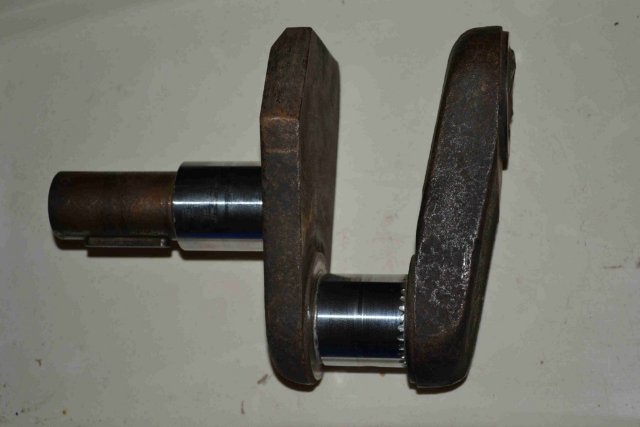

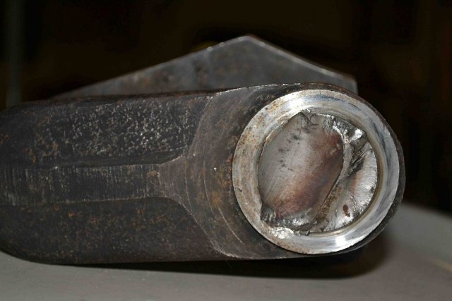

Vince Moore has done that but didn't gave too may details. See here : https://www.facebook.com/groups/rsrcomm ... 304323250/
Trying to fit Triumph shell bearing in an engine without in line oil filter resulted in a catastrophe. See pictures.
