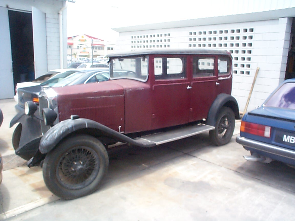

Post by paul williams » Thu Sep 25, 2008 9:26 am
This is a picture before I started the restoration.
ps the location is Barbados!

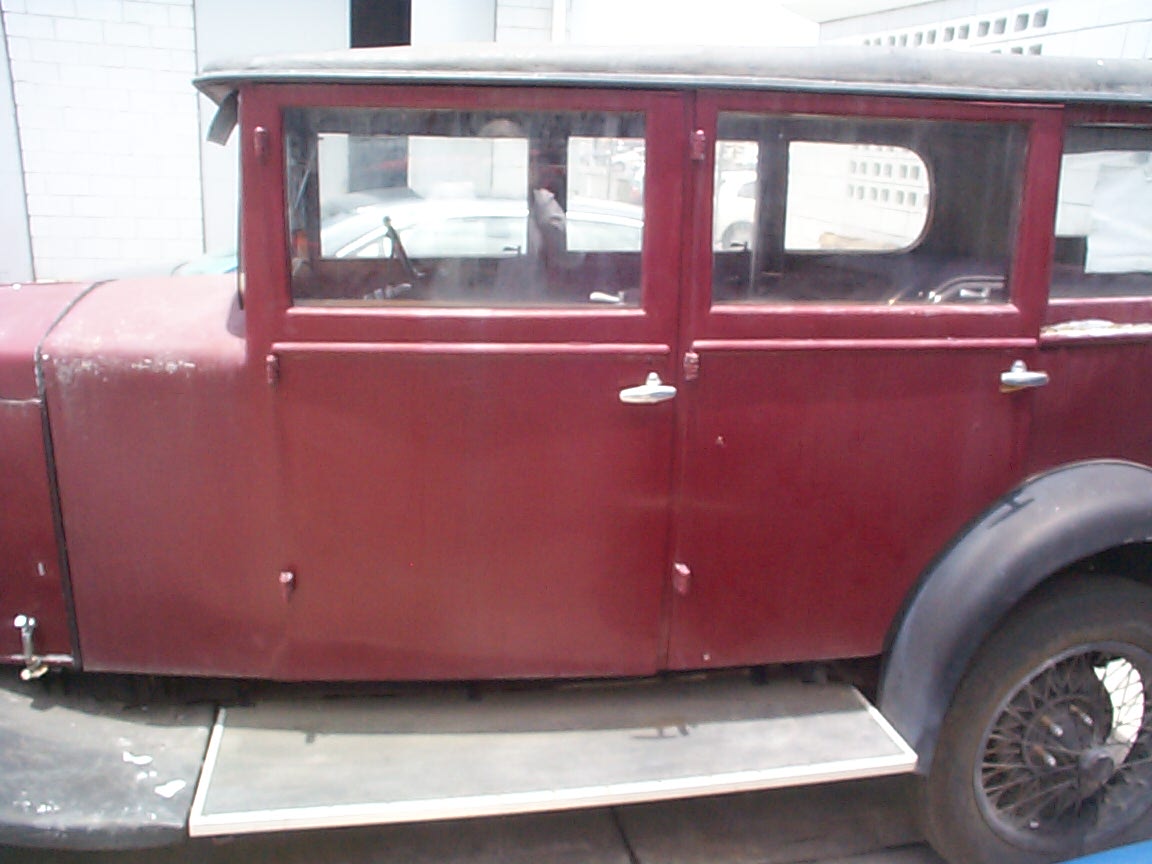

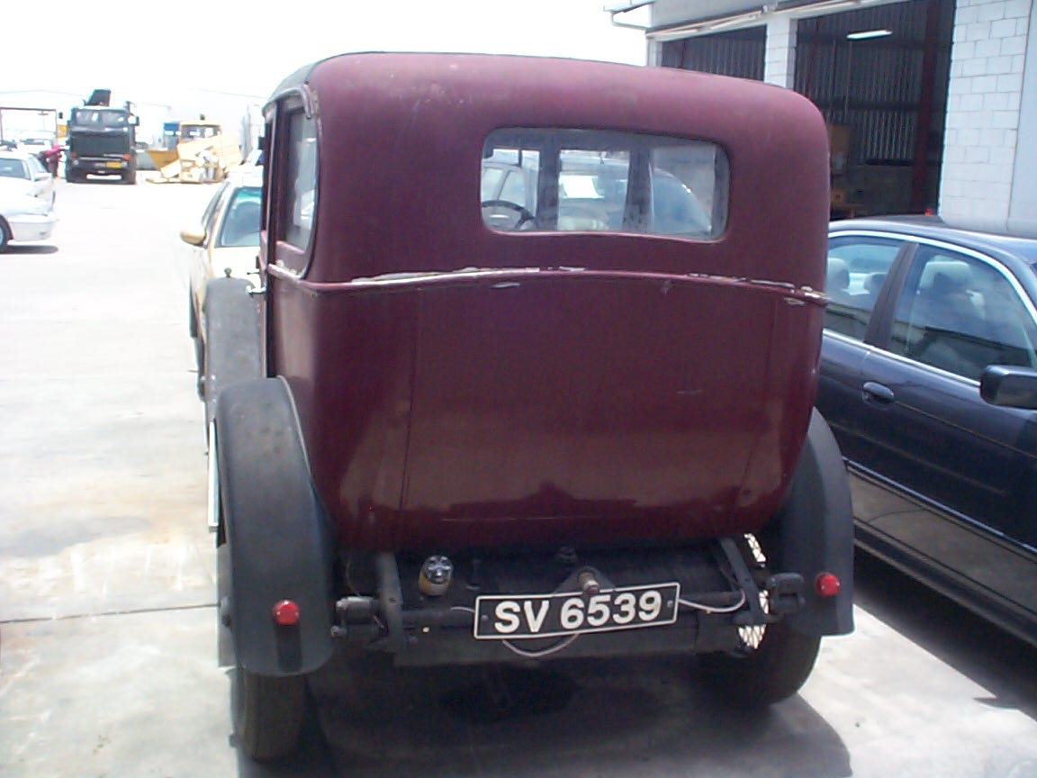

Post by paul williams » Sat Oct 04, 2008 10:26 pm
Thought I would add a few more pictures,

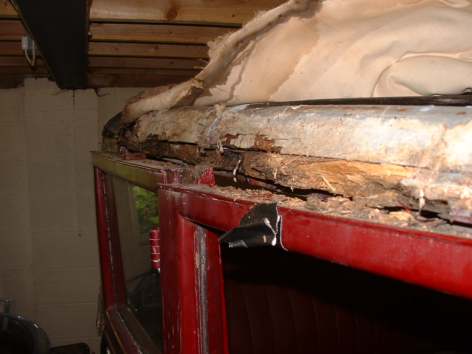

this one shows the extent of the wood rot
It shows were the 'B' post should connect to the top rail but it was just flapping about.

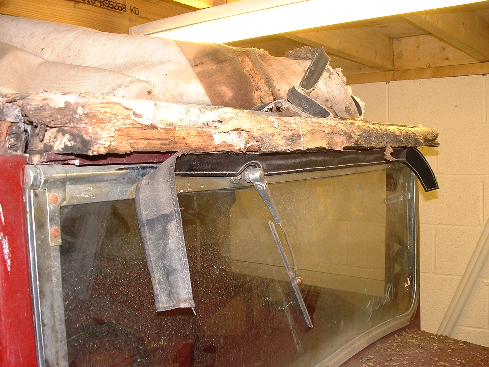

This is the top rail as it goes across the windscreen, it was just like weetabix, this was because it had stood outside for a few years in the tropics.

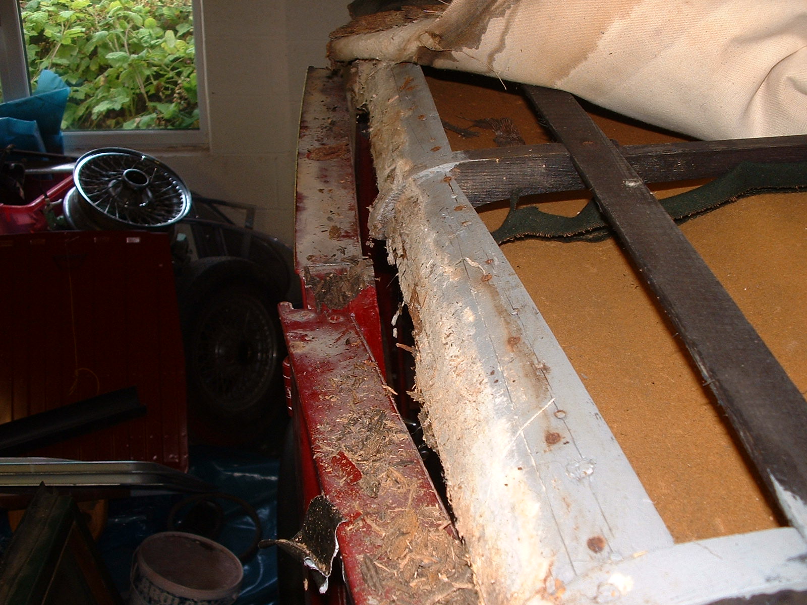

Another picture of the 'B' post

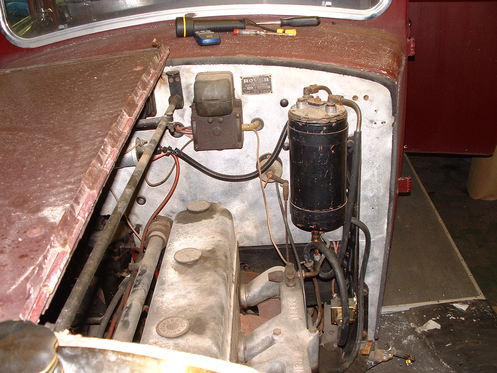

This pic shows the engine compartment which was complete and very little modified including the autovac

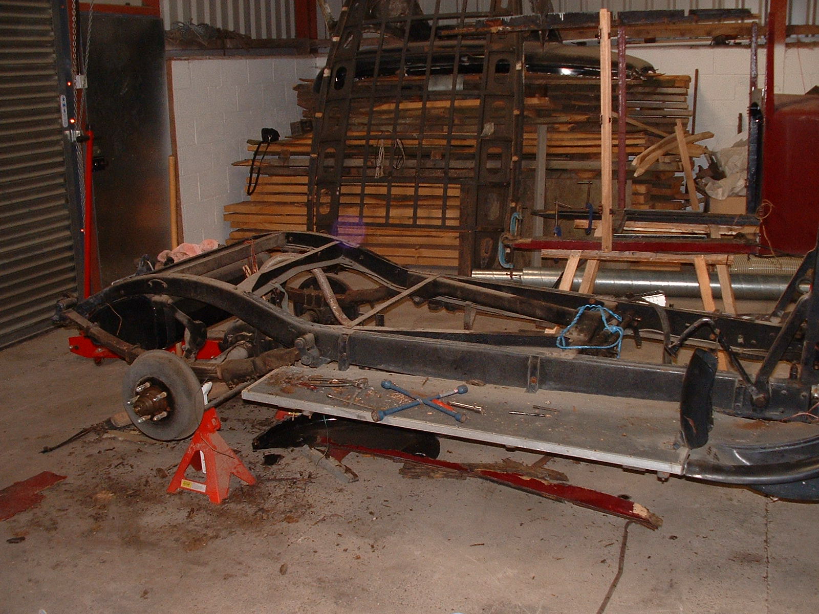

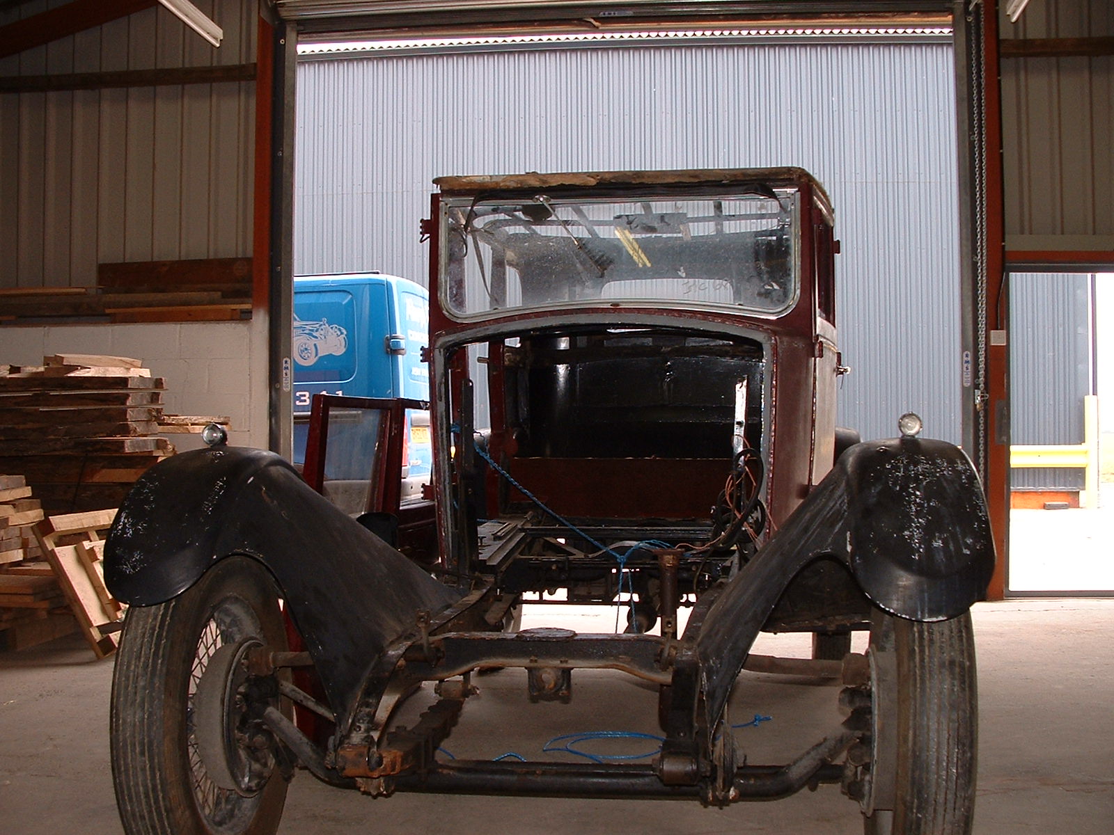

This is it now completly stripped to a rolling shell so I can measure and replace the rotten timber
Eventually got to this, just a chassis!
Then all I had to do was remake the wooden parts and rebuild!
More to follow
Paul
