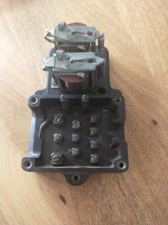

My charging problem was not very serious, I have had the original dynamo serviced, it only required new brushes and the front bearing, it is now back in the gearbox with a new chain. I intend to keep the original 3 brush system with as much original parts as possible. The cutout is an OCJ2 which is not just a cutout but has a second relay which Rover described as a boost relay, in reality all it does is force the dynamo to output full charge by connecting the Field and Output connections on the dynamo, this, Rover claim eliminates the need for a high/low winter/summer charge switch. The dynamo is switched to full output when the lights are on as well. I have checked the operation of the unit on the bench and the relays were out of spec with regards to their cut in and drop out voltages and the boost relay had been well and truly mangled by someone in the past, so I have replaced the cutout with a series diode (SM74611 Smart Bypass Diode) and the boost relay with a modern alternative, all within the cover, so not noticeable but still keeping the 3 brush system working.
If you are using a 2 brush dynamo as a replacement it wont charge at tickover, the cut out in the regulator wont connect until about 12.8 - 13.0 v output.
Paul
