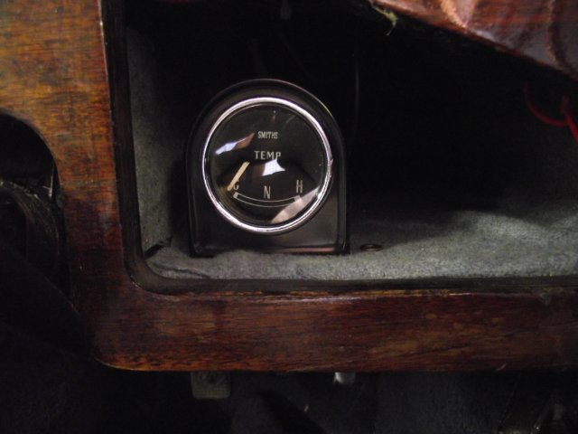

Thanks very much for the information ,The clutch has sufficient play in the pedal it just bites late,however its very light and has a strong bite,it pulls away quite easily ,with the handbrake hard on.So it will be a case of running it and if it needs doing,it could be a job for after the summer.Im just setting the carb. up I noticed that the vacuum barrel was sticking from rest position so I recentered the needle cleaned and oiled it (3in1) and it nice and free ,but it is too rich its hunting a bit on tick over.Also ,just fitted a temp .gauge ,I didnt want to cut into the dash I like to know how warm the engine may get The oil pressure is a nice 60 Lbs Len
