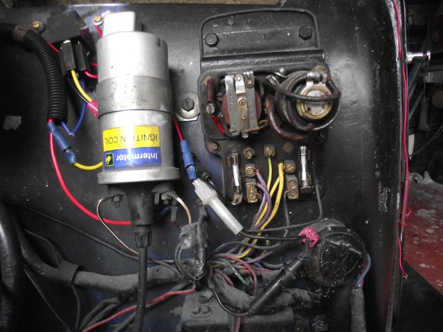

Post by digcot65 » Tue Apr 20, 2021 9:08 am
Good morning how do I test the voltage regulator on my 1934 car .I know the dynamo is working but the ign.light fails to go out
Re: 1934 Rover 12 Voltage regulator
Post by digcot65 » Tue Apr 20, 2021 10:52 am
Since the dynamo is giving an O/P and the ign.light stays on,it point to the regulator .Could a more modern regulator be fitted in its place .Im thinking any way of fitting a Dynamator Len

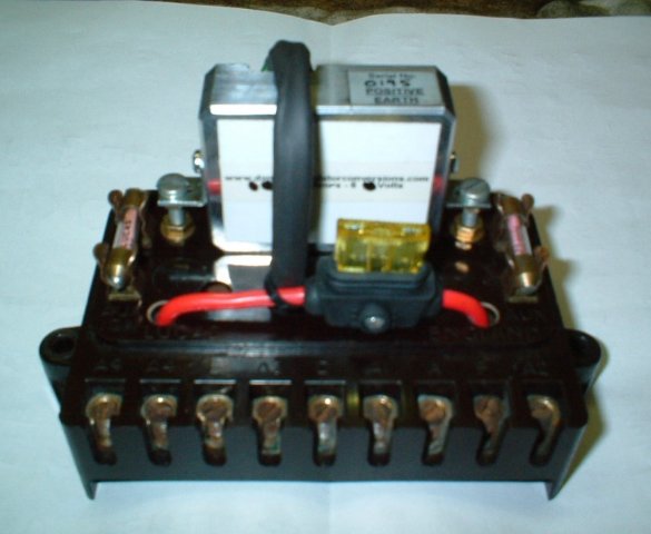

Hi All,
Opens the debate about originality verses reliability. On my 10/25 and my vintage bike I have replaced the old regulator with a modern electronic one. It can be fitted inside the old regulator box so all looks original from outside and gives much better regulation and is much more reliable.
Link to one the many sources and also has some useful info.
http://www.dynamoregulatorconversions.c ... lators.php
Stuart.

Post by digcot65 » Wed Apr 21, 2021 9:23 am
Morning ,they now offer a DVR4 ,which has an O/P of 15 aps,more suitable for cars .The original DVR2 was really only for bikes.They are £80 which you have to think is it worth spending £150 for a Dynamator,you then have a new generator and a new regulator Something to think about Len

Post by digcot65 » Fri Apr 30, 2021 9:47 am
After tidying up all the wiring and reconnecting bad joints,the dynamo is now showing a charge on the ammeter and the ign.light goes out.So changing to a Dynamator is a job that can be put on hold at the moment,since the restoration is still to be completed
