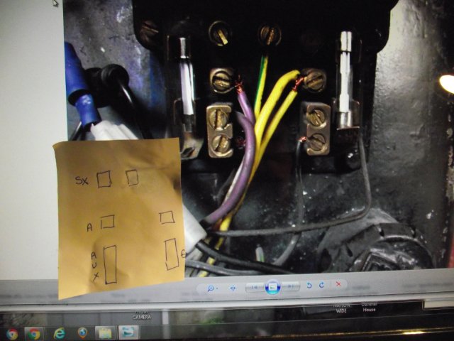

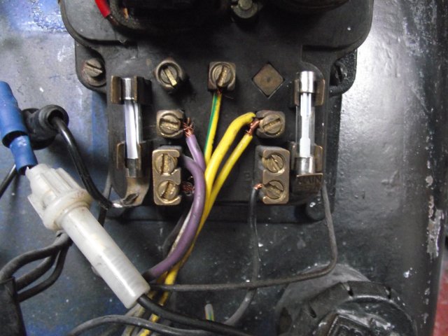

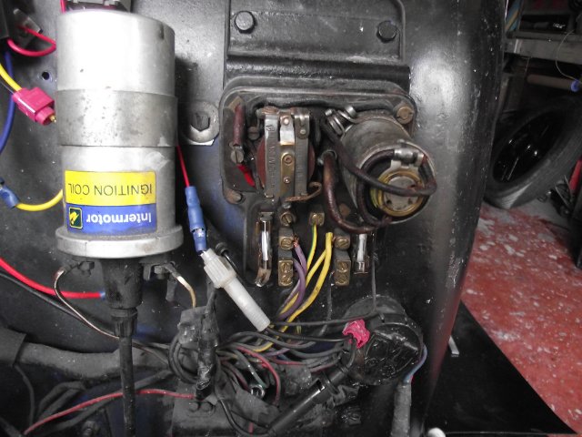

Post by digcot65 » Sat Mar 27, 2021 7:08 pm
Checked the regulator connections,and they are as shown, no connection has D on it.The top left is marked SX down one and its A bottom left is AUX. The bottom one on right is E cannot see a D on any Started the engine for the second time since buying it ,after double checking the timing and it ran for 2 seconds and stopped checked points and electrics and found the coil has packed up .Tested it off the car and not a thing .Oh the joy of restorong Len
