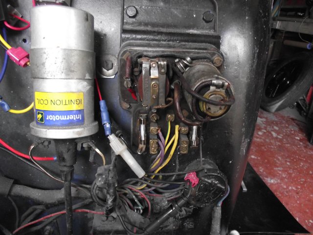

Thanks I1ve sorted the distributor out ,but I would like to fit electronic ignition,which I`m enquiring about.I have a problem with the cut out at the moment .The dynamo is giving out voltage but the ignition light fails to go out,when the engine is running.I seem to have the early type cutout on mine,which I cannot find any information about I would like to get that sorted before fitting an alternator,or do away with enough of the wiring not to matter.I know the later voltage control boxes are made obsolete after fitting electronic Ign.Len

Tony when you fitted the "alternator" onto your car ,was it the same type of voltage cut out box I have ,if so what did it entail Len

Forgot to ask has anyone with the same voltage control as mine,changed their car from Positive earth to Negative Len

Len,
I installed my alternator when I re wired the car so the new loom was made accordingly. As such, I just chopped the relays out of the regulator box and used the fuses. I’m pretty sure Accuspark provide a wiring diagram for fitting in place of a dynamo. The regulator shouldn’t be polarity conscious but it sounds like yours is troublesome anyway so I’d junk it and go for the alternator option. More reliable and greater output. Not original, of course, but then neither is LED bulbs, leaded petrol, 2 pack paint or plastic insulated wiring. All sensible upgrades though, except the petrol!
