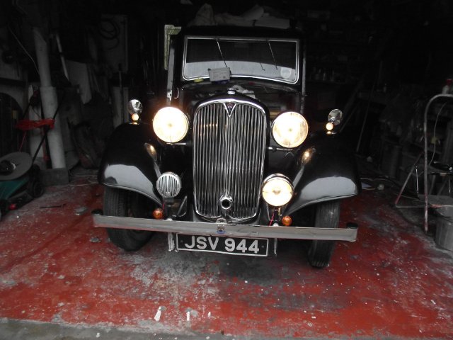

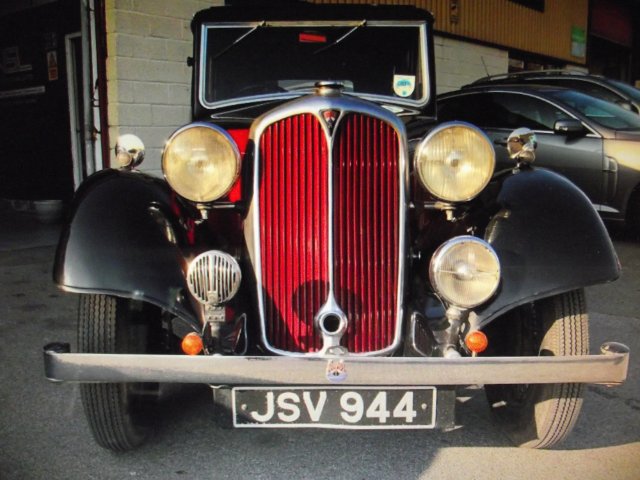

Hello I have wired a relay and an inline fuse into the new circuit.I have also fitted a warning light as demanded by law.I ran into a problem when wiring the lamp up ,every time I switched it on the inline fuse blew.I checked everything couldn`t find the reason tried again and another fuse blew. I thought I would try the switch even though it was brand new.The connection between the common tab and the earth tab was short circiut.This has now been replaced You`re fighting a losing battle,when new parts are faulty .The electrics are all finished ,with everything working.Now to make sure the working is all tidy .As I said earlier, I was an electronics and computer engineer some time ago.So car electrics don`t frighten me as some people are The car certainly look different with all new chrome and redone reflectors .Cost a fortune ,but where do you stop when restoring a car The indicator lights were there,when I bought the car and fortunately ,the semaphore ones still work ,though just for show Len

Forgot to add,this was the car when bought .The chrome work wasnt as good as the photo makes it look
