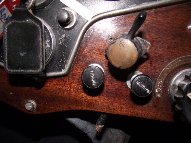

Post by digcot65 » Tue Feb 16, 2021 1:32 pm
Afternoon can any one tell me what this switch is for .There are three wires going to it and there is a the word ON stamped on the front. I imagine it is an original switch fitted to the car.The wiring of my car is in a bit of a mess ,with new wiring all over the place ,so Id like to get it sorted .I have the headlight wiring done the side lights work,the original trafficators work and the horn now works, but the indicators partly work and the fog light doesn`t work .Its difficult to trace wiring from the dash ,due to it being covered underneath . Fortunately I was an electronics engineer so not as frightened as I could be Len

Does anyone with a 1934-35 Rover 12 have a switch like this on their dashboard.It looks original,but over so many years who knows.Since I haven`t driven the car yet I have no idea what its for.Strange it has three wires with an" ON" position but I cant see any other letters Len

Not a genuine Rover switch as far as I know. The throttle knob is a hand throttle so to start the car from cold you may need to pull the mixture (choke) out and the hand throttle.
