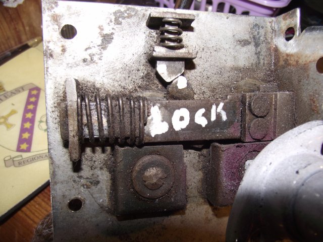

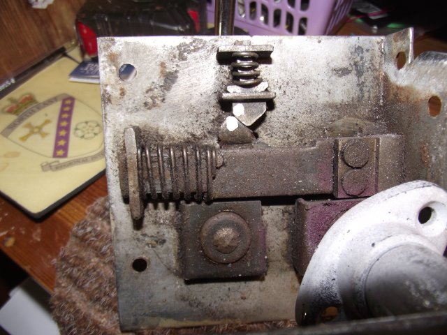

Post by digcot65 » Tue Feb 02, 2021 1:30 pm
Hello Ive removed the front door lock and you can see ,when the handle is pushed the one way to open the door OK . However if the interior door handle is pushed or by accident goes forward it locks the door from outside.So a simple job stop this happening I can stop the top section from rising up. . Spots next to each other door can be opened spots on different side door locked The door can they be locked from the outside,with the key.Len
Re: 1934 Rover 12 door handles
Post by digcot65 » Tue Feb 02, 2021 1:47 pm
Just put a spot of weld on the pawl,to stop it rising when the door handle is pushed forward ,which it can`t now I have piece of mind about being locked out and having to break a window I job done 999 to do Len
