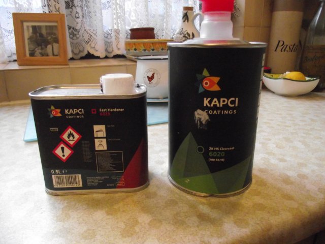

Thanks for the information, I use the two pack as shown,which is 2 parts lacquer 1 part hardener and 10% cellulose thinners .Give a light spray coat of the mixed lacquer leave it 30 to 40 mind depending on temp .Then another wet coat of spray followed an hour later by another wet coat and see if that is enough Then leave as long as possible to harden,flatten with 2000 wet and dry with plenty of water and polish with Farecla. I have a two handed mop for polishing the car with cutting past ,its not for polishing with a lams wool mop,its made for polishing after cutting with Farecla The base coat is the normal solvent based not water based.In theory an oxygen mask should be used I use a good 3m mask and only spray a section at a time then go out of the garage for a while,but it isnt nice paint Just lacquering the two front wings and half the bonnet,which was really dented ,it took me over 40 hours to get it near to good ,Never going to be as good as I would like but some things are impossible Also the car is 87 years old.Photo of the bonnet tomorrow just finished lacquering it Just the other half of the bonnet to do ,but that is also in a very poor condition ,solid no ruts but dents and creases ,found to e worse once Id stripped it to bare metal.At least its something to do during lockdown.Len
- DSCF0086.JPG (138.98 KiB) Viewed 6060 times

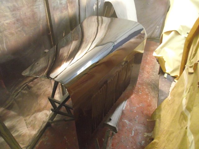

Finally sprayed one half of the bonnet after 50+ hours work on it ,spraying not being happy stripping .This happened more than once.I1m quite pleased ,there is some dust on the paint ,evn with the TENT but no where near as without one.Also the overspray doesnt go all over the garage and my tools.The thing is now to leave it as long as possible ,then flat it with 2000 wet and dry and then polish it wit my large polisher using Farecla on a damp mop.lEN
- DSCF0090.JPG (134.39 KiB) Viewed 6041 times
