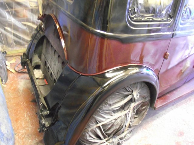

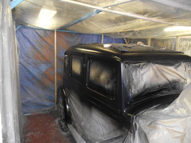

Finally finished spraying the car,I`ll leave it for a while before flatting with 2000 wet and dry and then polish it with G3 Farecla.The longer left the better,giving the paint longer to harden The "TENT" I built in the garage has been a godsend,there was still a small amount of dust settling,but no where near as it was without the TENT.While its hardening,I can get on with the engine and fit the steering when it returns.What is the bestoil for the steering box Len

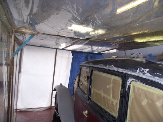

This is a photo of the "TENT" I said I built in the garage it has been a boon,if I go into the garage which can be quite cold,and I`ve had the heater on in the TENT, the temperature can easily be 65,then I have to turn it off,which I do before spraying anyway I also wet the floor well.It doesnt stop dust completely but it reduces it greatly, it so the body just needs 2000 wet and dry,before buffing . Shame to scrap the TENT when Ive finished but I can use a few of the battens .Len
Re: Rover 12 painted
Post by digcot65 » Thu Nov 26, 2020 4:03 pm

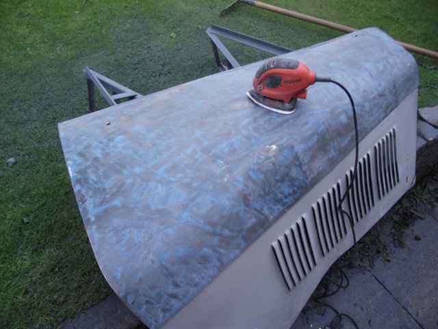

Post by digcot65 » Wed Dec 16, 2020 9:37 am

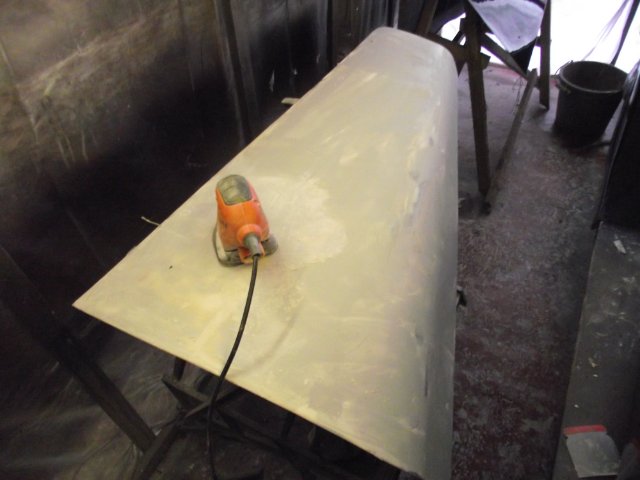

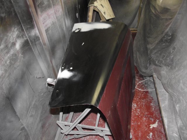

Painted the LH side of the bonet,which I will leave as long as possible,before I flat it with 2000 wet &dry then polish it with a mop and polishing compound .Now pre-pairing the RH side ,which when it was down to bare metal was quite dented and rippled.I skimmed the whole of the top surface with 2 pack body filler,flatted as well as possible ,then skimmed all of it with Farecla a fine surface body filler .The next job is to sand it as smoth and flat os poss.then undercoat it and spray a light coat of black base coat.When this has completely dried I sand it own lightly with 800 wet and dry using a long sanding block.Then the surface will show small patches of black, which means these are low spots .I skim these over with farecla again more black spray and repeat the operation.Hopefully when lightly sanded the whole surface should just show thw undercoat with no small cavities.How many times you do this depends on how much patience and time you have.The bonnet can then be sprayed in black base coat and when dry sprayed in 2 pack lacquer.Left as long as poss.flatted with 2000 wet &dry and polished.This is why to do a whole car takes a few hundred hours .Happy polishing Len
