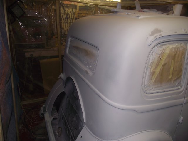

Hello I`ve built the "tent" and it may be less trouble to sell the car and grow tomatoes.I`ts come out as I hoped it would and it nice and light inside it Over the years I`ve sprayed loads of cars as my restoration hobby,but however much you clean the garage you still have to spend hours flatting and polishing the dust and bits out of the paintwork.I have a friend who offered to loan me his professional spray booth.But it meant getting the car in a moveable state ( no steering box in at the moment ) then if I could get it delivered there and pay him for the use of the booth.I could only borrow it at weekends ,so I would have to move it out of the way if not finished.This way the time is my own

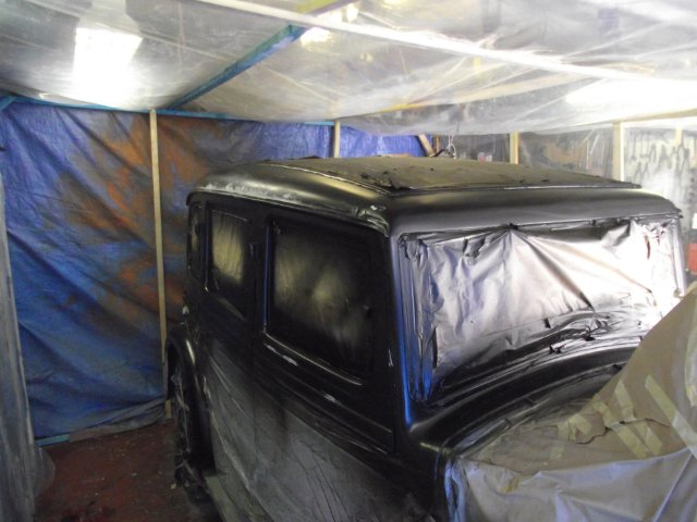

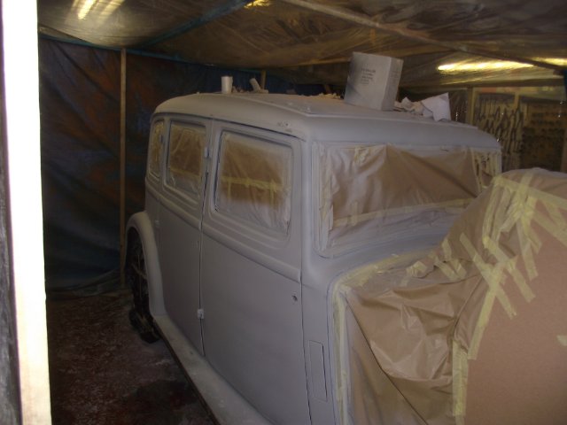

Getting there slowly.The U/C shows up even more blemishes but they are being removed bit by bit .I have anew HVLP spray gun and I still haven`t got the setting correct so it will take a little longer than with my old gun.It certainly doesn`t spray paint all over the place ,but is a much more gentle action.It must save paint as well .I`ve arranged for Steering Services to rebuild my steering box,they come recommended from the Forum Len

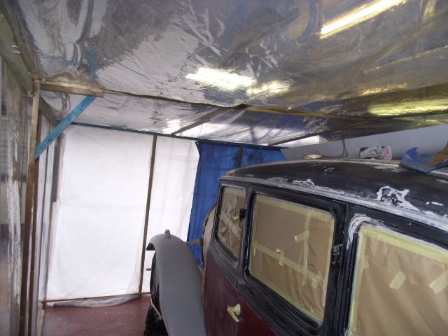

Gave the car a couple of of base coats,thinking I had removed every blemish,but sadly wrong as always happens a fresh coat of paint shows up everything So a few more hors of filling and sanding.At least it passes the time Len

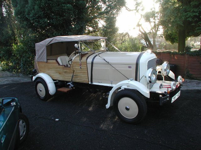

Hello again,this is a car I built some years ago out of a Post Office panel van.It was a kit car ,but after buying a few parts to get started,the owner of the kit company died,so I had to fabricate almost everything body,hood ,screen. interio.It really pulled the crowds in .Finally someone in Nice France bought it.I wish I still had it.The body was made by making a frame of3x2 wood and I founf a couple of hundred lengths of Ash 24" x2"x1/2" and between each bit if fitted on the frame I glued a strip of Mahogany 1/2" x 1/8" Took months but it was rewarding I managed to buy the headlamp covers but had to make the interior from S/S mixing bowls Len

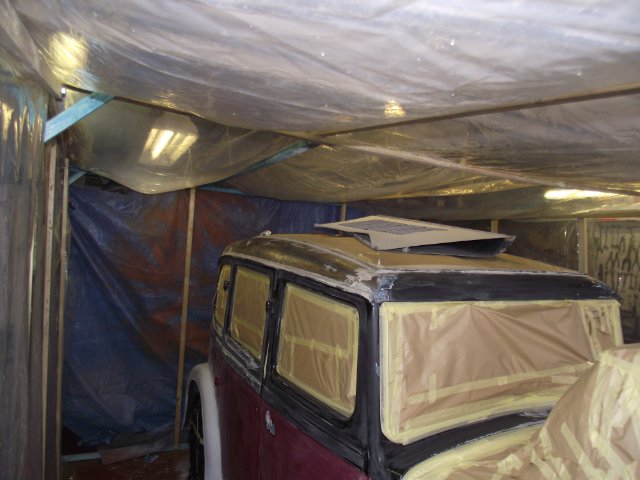

I went into the garage this morning,to give the bonnet a base coat,and the hammer fairy has been in again during the night. Just saw another ding on the bonnet as the light caught it dam those fairy`s .So a bit more filler and the spraying is delayed .Len
