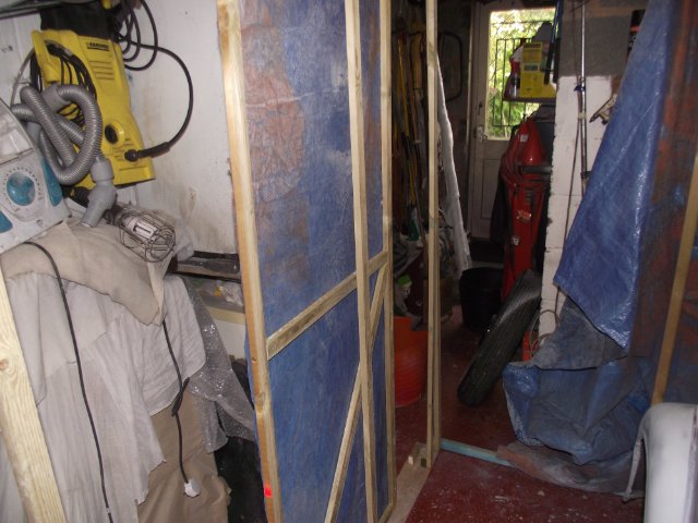

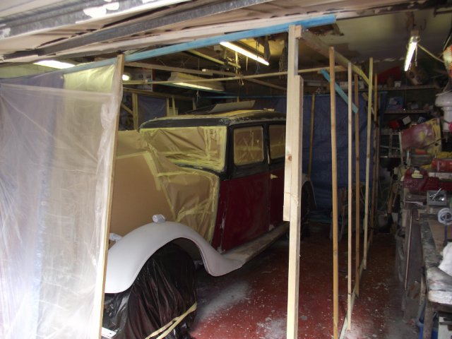

"TENT "making coming on ,waiting for clear plastic to arrive,I bought some of the very lightweight sheeting,but useless to work with . I remebered to make a door in the "TENT" so I can get out !!!! `m getting scared of going in the garage,every time I do I find another slight ding on the body I must have missed .With an 86 year old car,there is no end to getting it right.The problem is,the car had 4 damaged wings from catching gate posts etc. and the repairs were not very good with patches welded in which weren`t level with original bodywork,leaving it almost impossible to correct.At least it keeps one busy.Len
