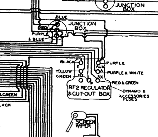

Post by luli » Sat Mar 27, 2021 9:07 pm
Look at the attached picture which speak for themselves
Re: 1934 Rover 12 ignition

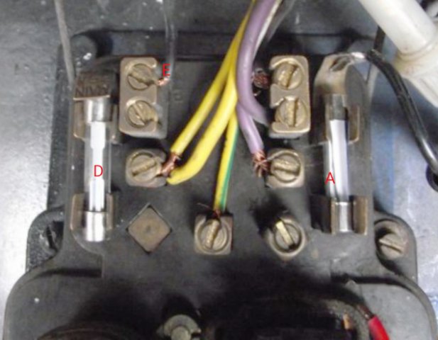

Post by digcot65 » Fri Apr 02, 2021 9:05 am
Thanks thats great,its viewed upside down but at last I can tie my connections up to what they are

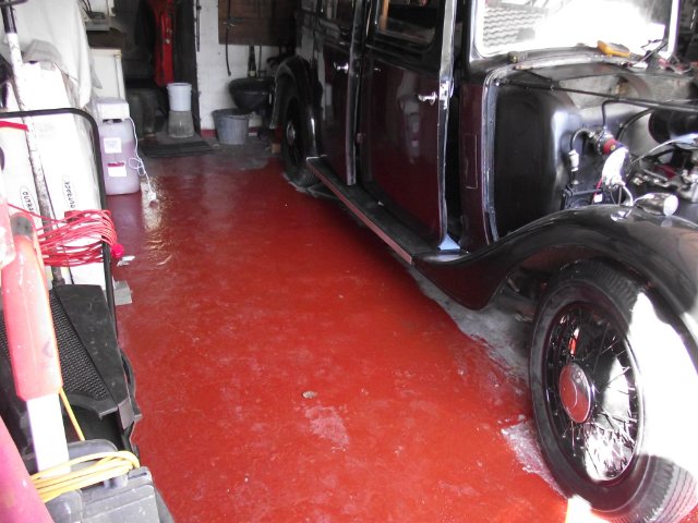

Post by digcot65 » Fri Apr 02, 2021 2:26 pm
Has anyone converted a 1934 to an alternator it would be interesting to know what connections are made and whats discarded .Starting to tidy up the garage after all the work.However you seal the TENT I made some over spray escapes Len

Post by digcot65 » Sun Apr 04, 2021 9:07 am
Morning happy Easter to all,thanks to the last drawing Ive managed to sort the connections out on the Regulator.It was almost impossible to see the D on the one connection.I now have to find a reasonable alternator conversion,which I may have done Len
