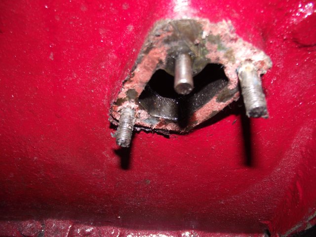

Regards to the pin that works the mechanical fuel pump.I can`t remove the pin ,it feels as though it may have to be removed from inside the crank case It feels as though there is a shouled on it when I try to pull it out Len

Given that it runs against a camshaft lobe, that would suggest that the pump push rod can only be removed if the cam is out. I’ve never removed the camshafts on either of my cars and, in fact, not stripped down the ‘37 engine at all. However, I’ve taken both rods out so either yours is just stuck or it is of a different design to mine, which seems unlikely. Maybe try some WD40 and moving it about to see if it frees up. Perhaps the constant movement through the crankcase has worn a lip on the inside of the rod? Maybe turn it 180* and try to pull it out then?

Morning,I`ve tried everything to remove the rod ,that actuated the fuel pump but no way will it come out .I`ve tried turning it through every degree there is I am wondering,if the inner end has been peened over with wear over all the years .It seems as though I may have to cut the last few mm off,to stop it fouling on the blanking pate I`m going to fix Sent the steering gear to ICS Steering Birmingham, its some place they have there very modern and very busy which hopefully is a good sign.I`ll let you know the result.While I`m waiting next job is to cleans the SU carb.Photo as it is now 86 years of grime.It was worrying to read about present petrol being phased out and the cost to classic car owners could be very expensive,to run on the future E10 fuel .There is always something they have to mess with.If petrol is due to be phased out any way ,why spend a fortune altering it now.

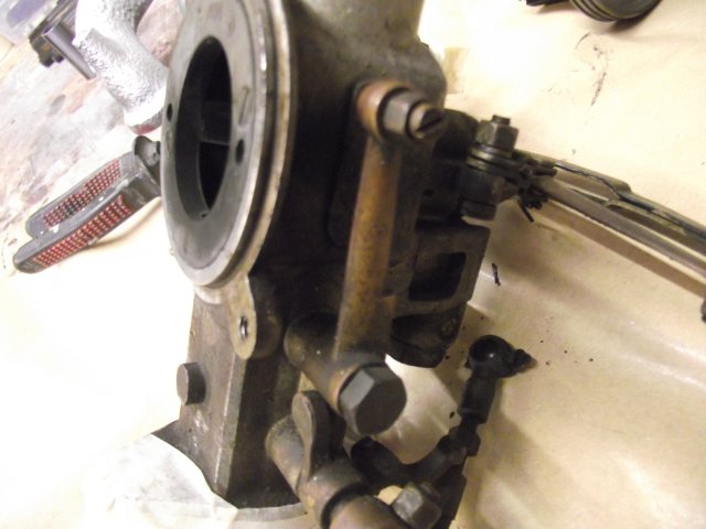

On the SU carb .there is the choke throttle and n=another lever for acceleration whats this

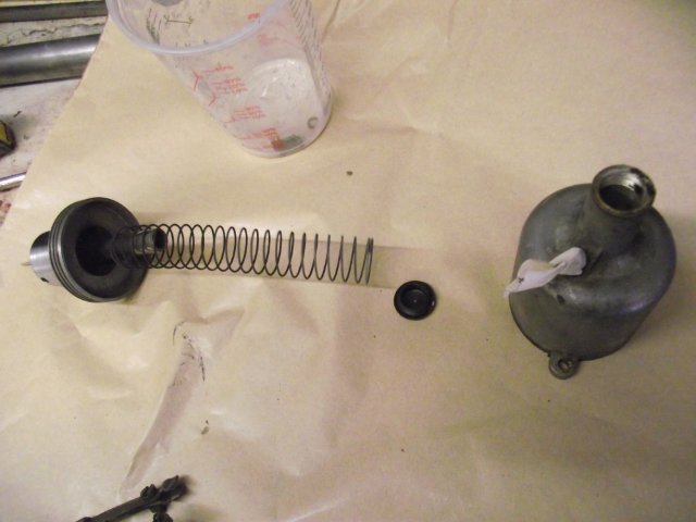

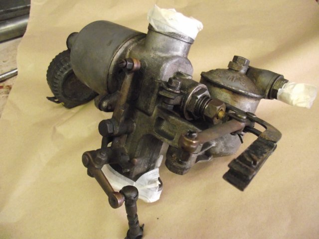

Started to strip carb.to clean and I noticed there is no damper on it .Usually as you unscrew the plastic top ,there is a plunger damper attached.Nothing on mine also what is the long brass lever for Len

Len, the long brass lever on the carb is the ‘Throttle’. You will see it operates on the butterfly controlled by the accelerator. On the dash board you should, or would have had, a throttle next to the ‘Mixture’ or choke control. Having both enables cold starting and increasing engine revs. Since rebuilding my Tourer four years ago I’ve only had the mixture control but this wasn’t really satisfactory and I’ve recently put a throttle in, which makes cold driving much easier.
The carbs on these cars are downdraft SUs, which are quite unusual. As such the piston is horizontal so a dashpot and plunger to damp the movement would not work very well. Don’t worry, nothing is missing. Burlen fuel services can supply a kit for refurbishing the carb which includes all the seals, float valve, a new butterfly and jet. However, if you want a new needle, you need to remove it from the piston by undoing the screw that holds it in and looking at the number on the flat side of it. As you may know, SU carbs of a given type all have the same jets but the needles and springs are the bits that vary performance.

Len, just looked at spare engine and taken sump off to see how pump is driven. As I previously said, it is a short push rod running directly on the cam. There is nothing holding the rod in place so it should pull out. Maybe some more penetrating oil and spend a while turning it round while trying to pull it out? It will be hardened steel so cutting it will be hard. Good luck.
